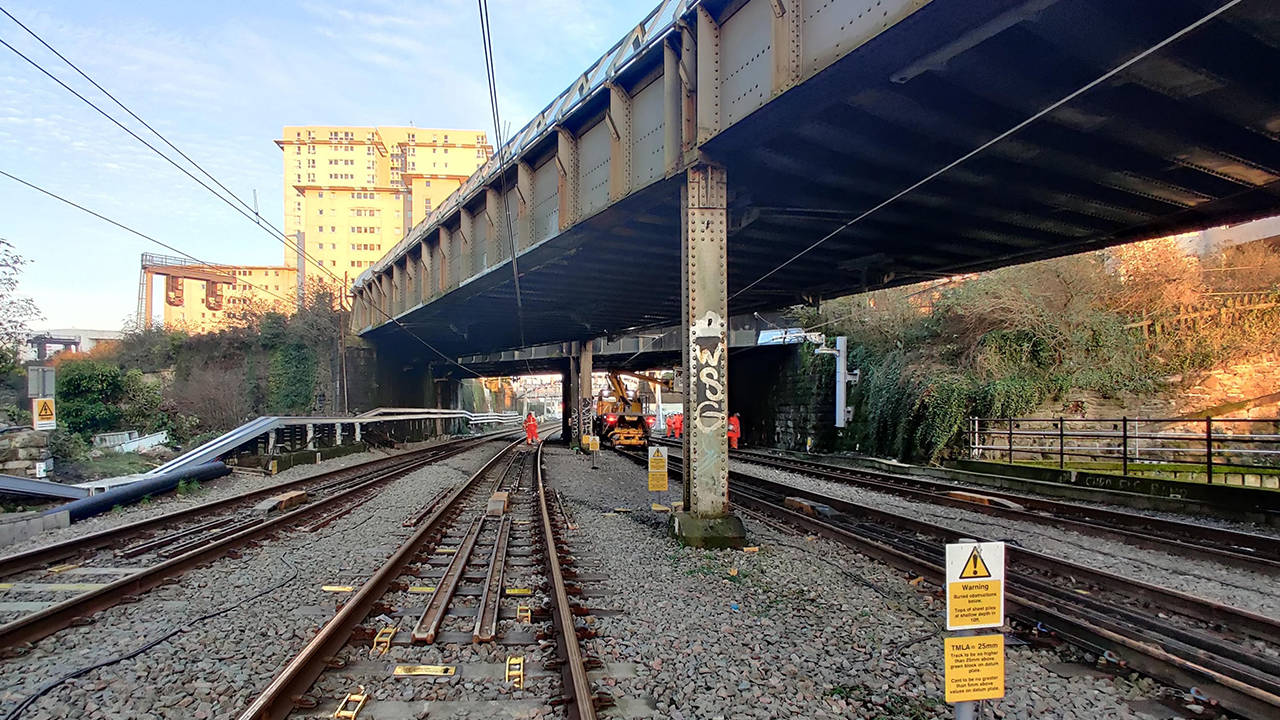

Whilst third rail and other low-level current collection systems add a lot of equipment to a railway at ground level, the general approach to electrification across the world has involved the adoption of overhead contact systems. In the UK, the early schemes tended to consist of installations at relatively low voltages and the clearance from surrounding structures was not a significant challenge.
However, technical advances arising from the need for higher speeds and heavier loads led the industry towards high-voltage overhead line equipment (OLE) which demanded much greater clearances. The initial higher-voltage installations accepted what would nowadays be quite conservative clearances for live equipment and consequently the early stages of the West Coast Main Line electrification involved a considerably quantity of overbridge reconstructions. The media was enlivened by images of exploding bridges whilst clever solutions for prefabricated new arches were introduced.
British Railways – as it then was – realised that the case for further electrification was at risk from the emerging costs and engaged in much significant development effort. This culminated in modified design protocols for the extension of the early work to complete the Euston-Birmingham route.
The early clearances were foreshadowed at a conference held in 1960 by the Institution of Mechanical Engineers and permission was obtained from the Chief Inspecting Officer for Railways to experiment with a view to determining minimum safe clearance dimensions. As presented in the follow-up electrification conference in 1966, revised electrical clearances were approved by the Minister of Transport in August 1962. This allowed the London Midland Region electrification to be completed at 25kV throughout and advantage was gained from the acceptance of the new dimensions for all domestic schemes.
However, the industry was determined to prove that costs could be controlled and an opportunity to show how arose within the Great Western Electrification Programme (GWEP). Recently projects have shown that civils work – especially bridge reconstructions – can make up around a third of the cost.
One example is the Cardiff Intersection Bridge, a substantial skewed crossing of the Cardiff and Merthyr line with the South Wales Main Line. Initial plans to reconstruct the bridge were estimated to be around £40 million. Alternative proposals involved lowering the track, rebuilding a culvert and pumping water from the canal around Cardiff city centre, which was estimated to cost around £20 million. Both solutions would be very disruptive to passengers and the costs threatened the viability of continuing the electrification west into Cardiff Central Station, only 400 metres away.
The challenge was met by a group consisting of Andromeda Engineering of Speke (Liverpool), GLS Coatings, Great Western Railway, Network Rail (Infrastructure Projects, Safety Technical & Engineering (STE) and Wales & Western Route), Pace Networks, Siemens Mobility and the University of Southampton (UoS) High Voltage Laboratory.
Andromeda Engineering, GWEP’s OLE designers for Cardiff, and Network Rail (Wales & Western), contacted Network Rail (STE) to propose an alternative design – initially in the form of a proof of concept – to avoid further descoping of the programme. A steering group was formed to bring in all the decision-makers and focus on achieving an engineering solution.
STE identified modern equipment from Europe that could assist with the challenge. This included:
Bonomi insulated bridge arms, supplied by Pace Networks,
Siemens 25kV surge arrestors, complete with Siemens Arrestor Condition Monitor (ACM)
an electrically-insulating coating from GLS Coatings (GLS 100R) that Network Rail had previously used for signalling power supplies.
The concept of Voltage Controlled Clearances (VCC) has been adopted by future electrification projects, including TransPennine and in Scotland. Collectively, it is estimated that VCC could save over £100 million. It will therefore play a pivotal role in making electrification more efficient and help to decarbonise the railway.
