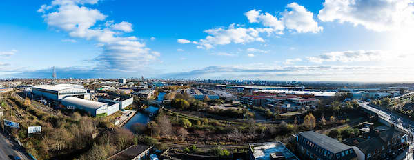

From OOC Station thread
The Victoria Road crossover Box technically isn't Old Oak common, but it's close - it's just to the west of the station
They've finished the sheet piling and are starting construction
Some pictures at
The plans are shown on
It's this part just north of North Acton
