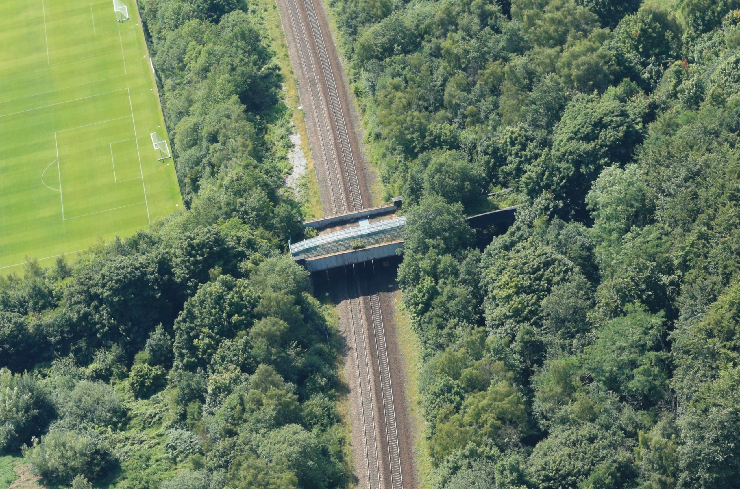

Press release
The newly reinforced Calder Valley line will keep passengers moving this Summer as Network Rail upgrades a bridge in Huddersfield to unlock space for more trains in the future.
As part of the multi-billion-pound Transpennine Route Upgrade, engineers will replace Fieldhouse Lane bridge in Huddersfield this August.
This essential upgrade will allow the bridge to support faster, more frequent trains in the future. It will also support the future doubling of tracks between Huddersfield and Westtown (Dewsbury) from two to four – a project which was given the green light by the Secretary of State for Transport on Monday 27 June.
Passengers can keep their plans on track while the work takes place over the first two weekends in August (Saturday 6 and Sunday 7, Saturday 13 and Sunday 14) as the majority of trains through Huddersfield will continue to run via Brighouse and the Calder Valley route.
People planning to catch the train should check before they travel via National Rail Enquiries or their train operator for the latest updates.
Over the last two years, the Calder Valley line has undergone major work to make it more resilient, especially when faced with heavy downpours. The improvements will be on show this August as the route is used at its full capacity, carrying an additional two trains per hour.
Further enhancements will eventually allow the Calder Valley route, which runs between Leeds and Manchester, to run an additional three trains per hour, giving passengers a better chance of finding a seat.
