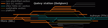

MarcVD
23 Aug 2016
1,016
Some trains don’t even change pantographs. Just open then close the circuit breaker.
Very few voltage séparations could be handled that way. Several of them have a small section of neutral catenary between the two different voltages. This neutral section is earthed. Going through that with the panto up would basically short and disjonct the two substations.
Example : former commutable station of Quevy, 3 kV= SNCB - 25 kV ~ SNCF
