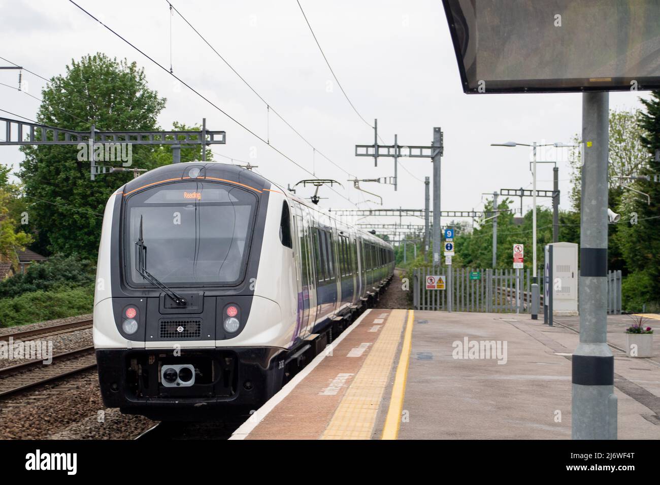

It looks like galvanised steel (i.e. coated with zinc as corrosion protection) to me, which is light grey and fairly reflective when new, but weathers slowly to a darker, duller, grey.
15,043
Bristol
The only station with an island platform between the reliefs and nothing on the mains on the electrified section of the GWML I could find is Burnham, and recent stock photos certainly show the electrification around there having weathered, but the arms are still shinier than the larger structural parts:
burnham-slough-berkshire-uk-4th-may-2022-an-elizabeth-line-train-passing-through-burnham-station-en-route-to-reading-the-much-delayed-crossrail-project-now-known-as-the-elizabeth-line-is-set-to-start-on-24th-may-2022-credit-maureen-mcleanalamy-live-news-2J6WF4T.jpg
(Stock photo of class 345 departing Burnham station take from the platform showing grey Electrification masts and gantries, listed as being taken on 4 May 2022).
For reference (in the photo), I'm pretty sure the tubular post supporting the mirror in the right foreground is hot-dip galvanized (the grey blotchy crystalline patterning is characteristic of that), as is the palisade fencing at the end of the platform (and probably the nearest vertical electrification post, but it's a bit too blurry to tell for sure).
