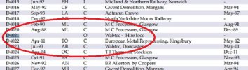

The only connection Westinghouse had with the 08 design would have been to supply braking systems and just possibly engineroom auxiliaries (pully belts, pumps, filters...). The 08 is an English Electric diesel in a British Rail built chassis and body, evolved from an English Electric design. Neither Westinghouse nor Wabco were involved in design or build. It was built by BR at a BR workshop for BR use. How it got to Wabtec later we don't know, but it could have been sold off by BR as redundant, or it could first have become under the control of one of the privatised rail freight companies before being sold on.
All that shows is that D4021 was disposed of at an unspecified date and came into the ownership of Wabtec and was being used as a hire loco. Interesting that there's no date given for the disposal

Is it possible that one of the historical East Coast TOCs did a sale and leaseback or hireback deal with Wabtec?
WesternLancer
12 Apr 2019
10,906
Good point - the other dates (well the ones with dates in the screen grab) look like scrapping dates and scrap yard locations / contractors - so the 2 in the list shown have not been scrapped so no dates in that column.
It's rather easy to see why the confusion could have arisen. Westinghouse supplies kit fitted on the 08's when built (brake systems), Westinghouse becomes 'Wabtec' in the modern era. Separately Wabtec takes over parts of the former BR railway works at Doncaster. This 08 is hired or bought by wabtec to work at the Doncaster site (a few pics on flikr show it operating there)
