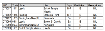

For the December timetable, XC have actually barred the use of staff travel facilities on some of their busier services, as have Hull Trains - see this document, as linked by @ainsworth74:
Perhaps the service you're trying to book is on this list?
I would ignore the 'avoid' list. It's essentially just a heads-up that the train might be busy and so you probably want to get a reservation.
