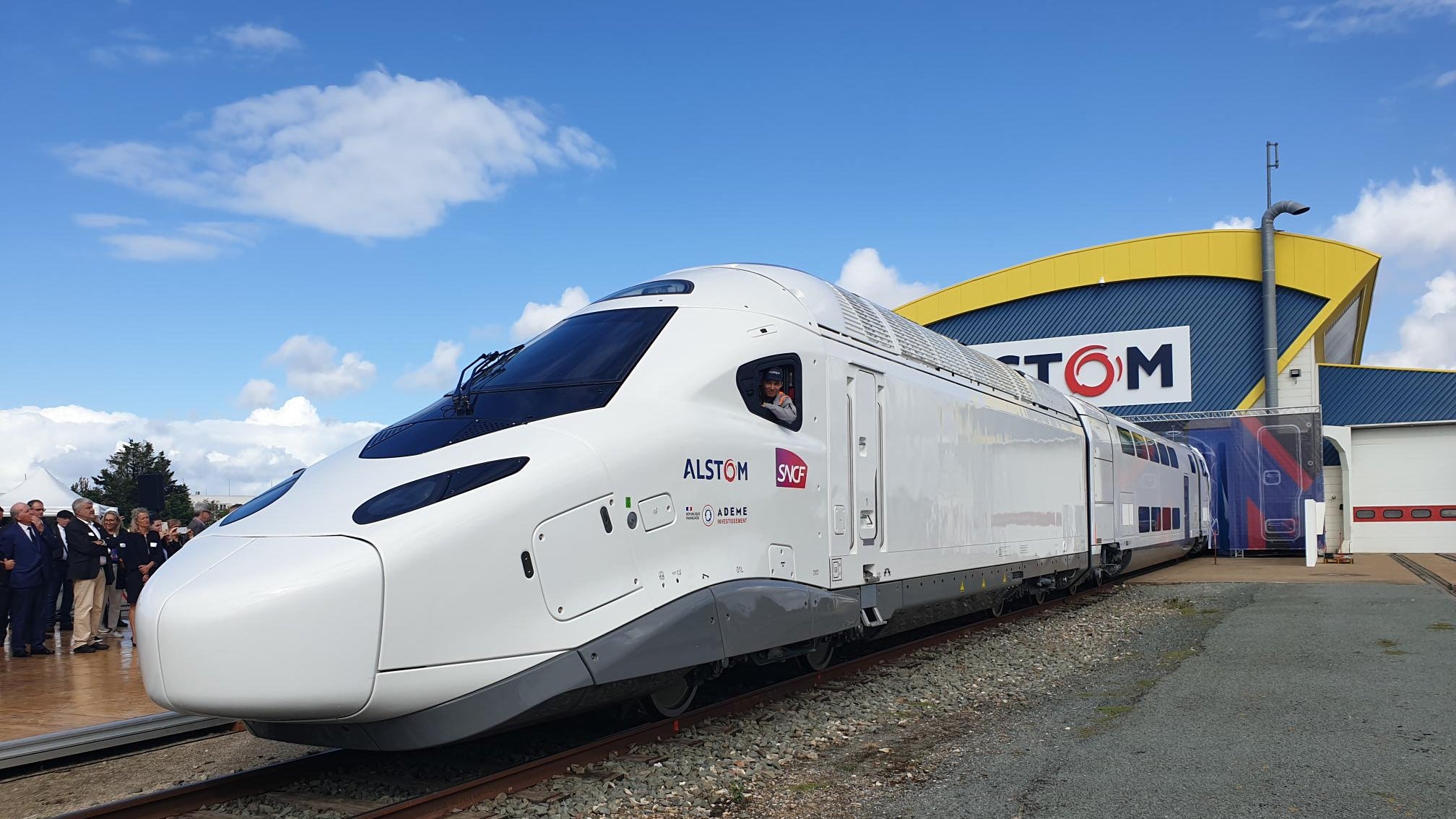

Did not see this posted. Interesting Alstom is essentially using the same power cars around the world. Amtrak's next gen Acela has the same power cars. Alstom stated acquisition costs had to be lowered so sharing the same basic train chassis or platform for International sales may be Alstom's way of keeping costs down.
May have to use Google Translate.
AngusH
27 Oct 2012
554
Fascinating, it looks just like the US model.
I guess if you like the shape better to keep using it.
And parts standardisation must be a good thing.
I wonder if there is perhaps some variation in the re-enforcement of the structure?
The US Acela were very heavily built IIRC to meet US regulations which don't apply in France.

I believe the power cars are standard globally, but the intermediate trailers are different.
The Avelia Liberty AFAIK uses trailers derived from the previous generation AGV & the SNCF order uses trailers derived from the TGV Duplex/POS.

The main thing about the new power cars is that they are shorter, which makes it possible to have nine instead of eight trailers, thus increasing capacity.

The power car and trailer profiles actually match! Nice :)
The Amtrak power cars are coupled to tilting single-deck trailers. Because they ended up non-tilting, unlike the early computer-generated visualisations, there was bound to be some mismatch along the body profiles. These French double decker trailers don't need to tilt and couldn't anyway, so the body shape can be made to match more easily.
