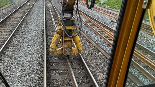

What I think was the same machine was working in daylight over the Christmas shutdown. I didn't get a really clear view of it due to trees, but it appeared to be a road/rail mechanical excavator with a small wagon on each side (with short lengths of rail on at least one, but this may just have been ballast). It would move a few yards, extend and lower its arm which appeared to have some kind of tool on the end rather than an excavator bucket, produce a sound something like a metallic 'clonk', and then raise the arm before moving a few more yards.
Any ideas about what it was doing? Maybe tightening rail fastenings or something like that?

Might it have been using an electro-magnet on the end of the excavator arm to collect scrap rail fixings (or other small steel objects) and drop them into the wagons? That could account for the metallic clonks. I have seen that sort of operation, though not recently.

Sounds like an RRV with a hydraulic attachment chopping up scrap rail into short lengths ready to be picked up by another RRV + trailer.

The sound occurred when the arm was extended and lowered towards the track rather than over the wagons.
But it was a single 'clonk' each time rather than a sound of sawing through metal.

It's a hydraulic cutting head rather than a saw. Kinda scary how much force is developed.
(YouTube link is a short video of a hydraulic cutting head cutting a short length of rail in two)
That seems a likely possibility, thankyou -- I didn't realise there was anything that could cut rails that easily.
