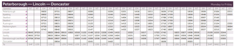

The trains on the ECML (certainly LNER) runs to a clockface so you'd imagine the freight trains joining/leaving need to fit in with that, but not sure exactly what EMR is doing with its erratic service - see M-F northbound example below
Starts off OK (0632, 0731), slips a bit (0837), misses an hour (1030), then misses another hour (1226), gets a bit earlier in the subsequent hours (1321, 1416, 1511), slips back towards the bottom of the hour (1626), then earlier again (1710), then later (1818, 1926) and then who knows (2104, 2311)
Welwyn of course another issue, I've experienced first hand on several occasions grinding to a halt and waiting at Woolmer Green for several minutes to be undertaken by a late running GNTL service on the Up Slow with added insult to injury of it then stopping at Welwyn North causing further delay.
Clearly another Welwyn Viaduct and rebuilding Peterborough (again) could fix these issues but it 'ain't gonna happen'. An additional crossover and common sense at Peterborough, a faster turnout to the Up Slow before Huntingdon and more common sense at Woolmer Green could made a big difference.
