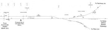

Singling the section through the (short) tunnel may be more cost effective than lowering the trackbed should there not be sufficient clearance to wire both tracks. It’s a solution that’s been employed elsewhere. There is already a single section immediately after Filton West so it could be simple just to extend that by severing the second track and slewing the remaining one at the tunnel. They could probably get away with taking the second track out of use now anyway, save a few quid on maintenance.
That’s your view. I disagree. Have a look at this diagram:
As well as the 302 yard tunnel, you want to single the line through where the new North Filton station is going to be built. The plans for this station show the existing double line railway. It would be unwise to remove the ability of one train to pass another at this point. Especially as there are still some freight trains that use this line.
Incidentally, this line was only opened on 9 May 1910. So in railway terms, it’s relatively new compared to all the other railways in the Bristol area (excluding small cut-offs and the Portbury line that joins to the
Portishead line).
I can’t remember how much clearance there is in this tunnel. But at only 302 yards, it’s a lot, lot shorter than Box Tunnel or Chipping Sodbury Tunnel. Also, the railway should have relatively modern records of this tunnel, as when the line was redoubled, extensive work was done to the track bed through the tunnel. And further work has been done since.
