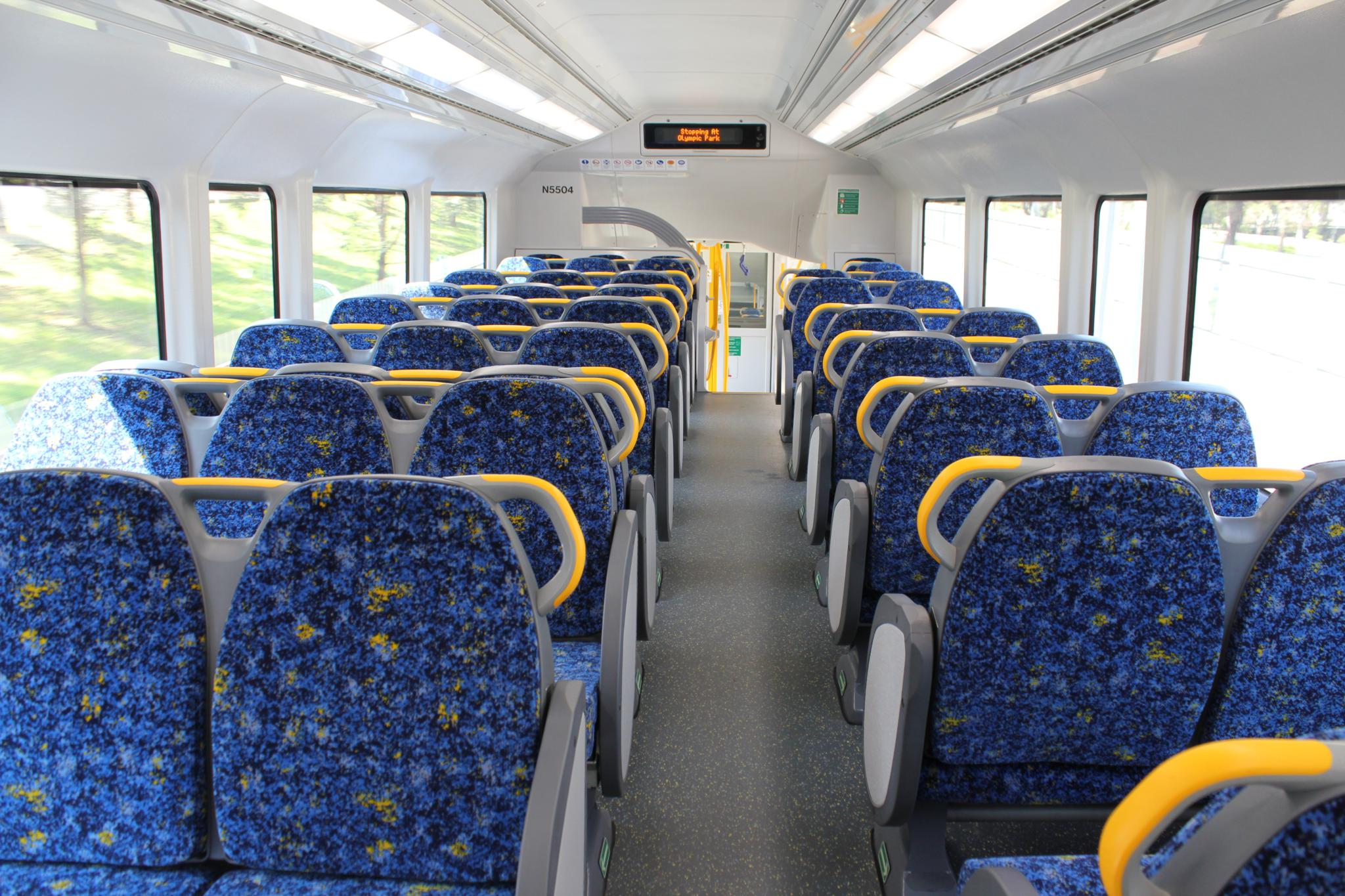

A few have mentioned the double decker trains used in Sydney. I've never experienced nay problems with delays in boarding/alighting these trains. The mose recent incarnations are the 'A' trains.
Vestibule area
Stairways and doors
Lower deck
Upper deck
Come along now you know you cant have 3+2 seating in the uk - it is scandalous!!
