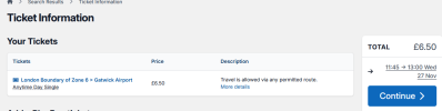

Sorry for the basic copy of a earlier thread of mine about BZ6 to Gatwick
I bought a ticket from the forum website for a STP to Gatwick, while holding a Off-Peak Travelcard
I clicked checkout a bit too fast and have a East Croydon to Gatwick Any Permitted instead of the BZ6 I wanted, but that should be fine for the itinerary I initially want.
But to still have options, is this part of the zonal tickets split exemption and is it valid on Gatwick Express?

No need for the train to call as you have a Daily Zonal ticket.
Presumably you searched specifically from ECR, rather than from Victoria with the existing Travelcard held option selected?
Some GTR staff think their GX brand is exempt from normal ticketing rules and may erroneously claim it is an invalid combination; if required to purchase a new ticket, I would do so under duress and take photos of the original tickets and replacement tickets, and feel free to contact me for advice on obtaining a full refund. (It would be very foolish of GTR staff to do this, given the impending legal action against the company, but nothing would surprise me!)
I searched for St Pancras (as this is where that journey will start) to Gatwick and it gave me a LU + Thameslink from London Bridge which is fine for me (I mainly just wanted an accompanying itinerary for my own planning)
But I just wanted to make sure I have plenty of options to reach Gatwick, thanks a lot
If I end up using GX, what ticket should I insert in the GX gateline? The extension I imagine?
72,891
Looks like we default to a specific station if the train calls there, otherwise BZ6 is offered if there is no call.
Specifying via VIC, and selecting a GX service, I get BZ6 fares offered:
The Croydon ticket is still valid and I would definitely encourage you to use it on GX, to check that GTR are behaving themselves as I would be very interested to hear if they aren't! ;)
