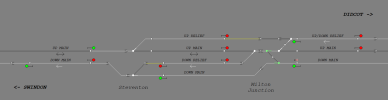

In 1932 the GWR four tracked the line between Challow and Wantage Road (including the stations). Some of this has been removed. There was also four tracking near Oxford added ahead of D-day in 1940s
The Four tracking is often suggested, but it actually just needs a third track, with the centre one reversible to allow slow freights to be overtaken (I am sure Didcot-Swindon has been full bi-directional since mid 1970s).
Given the layout at Didcot, having the third track on the north side makes more sense. And Didcot-Swindon is Bi-di but reduced capacity on wrong-direction moves.
It was all removed in the 1960s and 70s when the line was modernised and resignalled. Much was restored in the early 90s as part of the freight-sponsored 'ESI(P)*' scheme to accommodate trains of imported coal between Avonmouth and Didcot Power Station.
There's already a north side bidi relief line heading west out of Didcot station as far as Milton Jn, and a down freight waiting for its path can then cross both main lines to weave into a long down goods loop extending nearly a mile west to Steventon.
With the reliefs (slows if you insist!) either side of the mains between Wantage Road and Challow, something that might help is swapping positions of the down main and down goods loop between Milton Jn and Steventon. That would create a middle line that a down stopping or freight train crossing from the north side could drop into, traversing the up main while there's a margin even though an express might be zipping by simultaneously on the down main, which the slower movement can then slip out behind on a yellow, sprinting to the turnout at Wantage Road to get out of the way of the following express. Possibly the next best thing to a grade separation. Something like this:
That design is very good, if the alignment is possible to maintain 125mph with the DM on the outside, as it's basically a replication of the loop between Crewe and Weaver Jn (Hartford-Acton bridge?) on the WCML.
Personally I'd prefer to extend the bi-di relief out to Wantage itself, and then replicate your design with Wantage-Challow, but I'm not sure if there'd be room for 3 tracks through the village without taking out some garages. If you can, then Down freight would be able to skip the rather inefficient practice of looping at Milton Jn, Steventon and then Challow in such a short space, while Up freight would loop once at Wantage Road and then have a clean run to Foxhall Jn.
There would be only need for 110mph on the DM (and UM) as there is 110mph PSR at Steventon Bridge .
That PSR just need to be extended eastwards slightly to allow down trains to get to the “loop” and back without losing any time .
