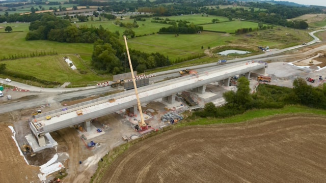

HS2 has announced the first precast sections of Edgcote viaduct have just been installed. Photos on the link
HS2 has begun assembling the half-kilometre long Edgcote viaduct, which is set to become only the second in the UK to have all its major structural elements manufactured off-site helping to speed up construction, boost efficiency and reduce the number of lorry movements on local roads.
Set low into the landscape of West Northamptonshire, the 515m-long viaduct will carry the new railway across the floodplain of the River Cherwell, south of Chipping Warden.
The structure was redesigned last year, copying the approach used at HS2’s Thame Valley, near Aylesbury. This lighter weight design cuts the amount of concrete and steel in the viaduct, with the piers, beams, deck planks and parapet manufactured off site at a facility in Kent.
Edgcote and Thame Valley are amongst more than 50 major viaducts being built as part of the HS2 project, which is designed to free up space on the most crowded part of the existing West Coast Main Line and boost economic growth.
Instead of five beams per span, secured with concrete poured on site, the twin viaducts use just two larger ‘u’ shaped beams per span, secured directly to the neighbouring beams.
This innovation - inspired by viaducts on the Spanish high speed rail network - will reduce the number of lorry movement and speed up construction by removing the in-situ concrete work.
At between six and eight metres high, the viaduct will be supported by 20 pairs of pre-cast concrete piers. These must be carefully lifted into position with their steel reinforcing rods slotted into pre-prepared sleeves within the pile caps. The gaps are then sealed with grout.
Well at least that's two viaducts on HS2 with a commonality of design. One has to ask how many of the other 48 major viaducts on the route have different designs with all the costs (design, construction, maintenance) associated with that.
"The structure was redesigned last year, copying the approach used at HS2’s Thame Valley, near Aylesbury. This lighter weight design cuts the amount of concrete and steel in the viaduct, with the piers, beams, deck planks and parapet manufactured off site at a facility in Kent."
