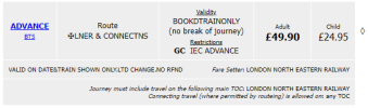

It is difficult to say whether the "& connections" is really aimed at the user or not, or is simply part of the purchase process. The naming of the main operator is certainly to signify that the journey must include that operator. For example, many LNER & connections tickets are not available to use Thameslink or Great Northern between London and Peterborough, presumably because people used to be able to specify "Via St Neots" to get a cheaper fare.
Compare these three fare levels for Lincoln to Basingstoke, taken from BRFares. On one the connection is valid on any TOC, another is valid on most TOCs, and the third a smaller number of TOCs, specifically not including Thameslink and Great Northern.
[Screenshots show information from BRFares about which connecting operators are valid for a specific tier of "LNER & Connections" advance ticket.]
As you note, some advance tickets don't print "Operator & Connections" any more and instead have text which says the ticket is valid on booked trains only.
The best thing is to take notice of the connections the booking engine is offering at the time of booking and make sure that you have the most appropriate connections booked in the first place, whether with regard to times or fare, given that the connections specified, rather than the trunk leg of the journey, can sometimes dictate the overall cost .
The difference between the ticket types you have shown is that they were set up at different times, with the paperwork almost certainly completed by different people. As far as I know there is no actual difference in the availability of the fares and if there is, it is likely to be accidental.
