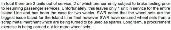

Says the wheels are from "“a scrap metal merchant” after a senior official from the Department for Transport (DfT) told the railway company that “Minimising expenditure must be the focus" ".
But the wheels are actually a loan from GWR.

I stated in the comments to the Observer article that the wheelsets were from GWR. The Observer replied and actually showed part of one of the documents released through the FOI request. If you look at the articles comments you will see the document and my responses. The document clearly states 'SWR noted that the wheel sets are the biggest issue faced for the Island line fleet however SWR have secured wheelsets from a scrap metal merchant which are being turned to use as spares.' Are you saying the Oserver have made this document up. Where is the evidence for the GWR loan. I am more than happy to go back to the Observer and tell them they are wrong. PS If they haven't made the document up that would suggest that SWR told the Dft that they got the wheelsets from a scrap metal merchant. The question then is why?
Below is part of the document that the Isle of Wight Observer claim they received as a result of their FOI request, written up apparently by the DfT. It clearly states 'scrap metal merchant'
Scratching my head.
It says
3 out of service,
2 of which are subject to brake testing,
leaves only 1 unit in service.
But there are five units so three must be in service.
So I would not read to much into that quoted piece.

I think one of the points of the Observer piece is that the Dft note suggests one of the 484's has already been cannibalised. Thus if that thesis is accepted with 3 units out of service (2 on brake testing) that would leave just one unit in service. I can make no comment on that claim.
