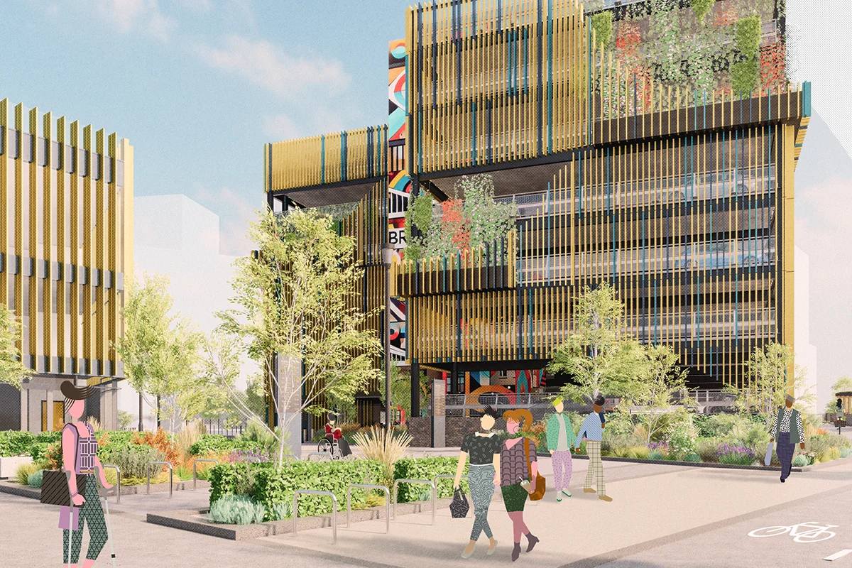

Am I right in thinking that Bristol west Junction is being upgraded in a few years? or is that simply track renovations, sleeper replacement etc. I do remember reading somewhere that the intention was to bring platform 2 back to use as well as a west junction upgrade.
Work is still going on the area.
A new set of proposals called Southern Gateway which involves building a multi storey car park (to replace many of the scattered railway parking) was issued just 3 weeks ago (see link). This adjoins the western end of Temple Mills station (there is an interactive map on page 8 which appears to include a track layout)
Although it adjoins Bath Road, it is not the old diesel depot site of that name (which I think is now referred to as Temple Island)
