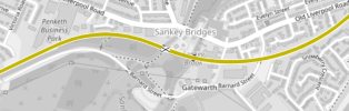

Here's my suggestion on what NPR might build through Warrington.
I do like the idea of putting the new WBQ platforms on a viaduct going over the WCML lines, rather than trying to fit them in to the existing low-level route.
This is how I would run a 2km twin-track viaduct (Orange) with 265m platforms at WBQ (blue).
The tightest curve has a radius of 450m, which is fine within 1000m of a station where all trains will stop. The curve could be made straighter with minimal residential demolition.
Gradients would need to be 1.5%, which is fine for a non-freight line, or the viaducts could start further back if less steep approaches were necessary.

Some very good points raised about the height differentials by yourself and @MarkyT making a flyover perhaps the best option. If we want the line to be entirely HSR (200-230kph), and for select trains to pass through to get fast Liv-Mcr timings, perhaps a combination of these proposals (with a link to Chester/North Wales) might be optimum? I've drawn it out with 1800m curves suitable for High Speed, and also a radius wide enough not to present accessibility issues for platforms (which would be on the curve)
Presumably you'd grade-separate the junction toward Chester somehow too (not shown here)

and a new railway across where the £200m Western Link road is supposed to go.
The Western Link road bridges the Ditton Goods Line. This image shows the intended design of the northbound carriageway bridge. It allows 5.8m above rail level and a 12.8m clear span.
Unfortunately, the location of the new bridges will constrain the route of the Ditton Line around the Sankey Bridges, as shown here , which will limit the future speed of the line.
