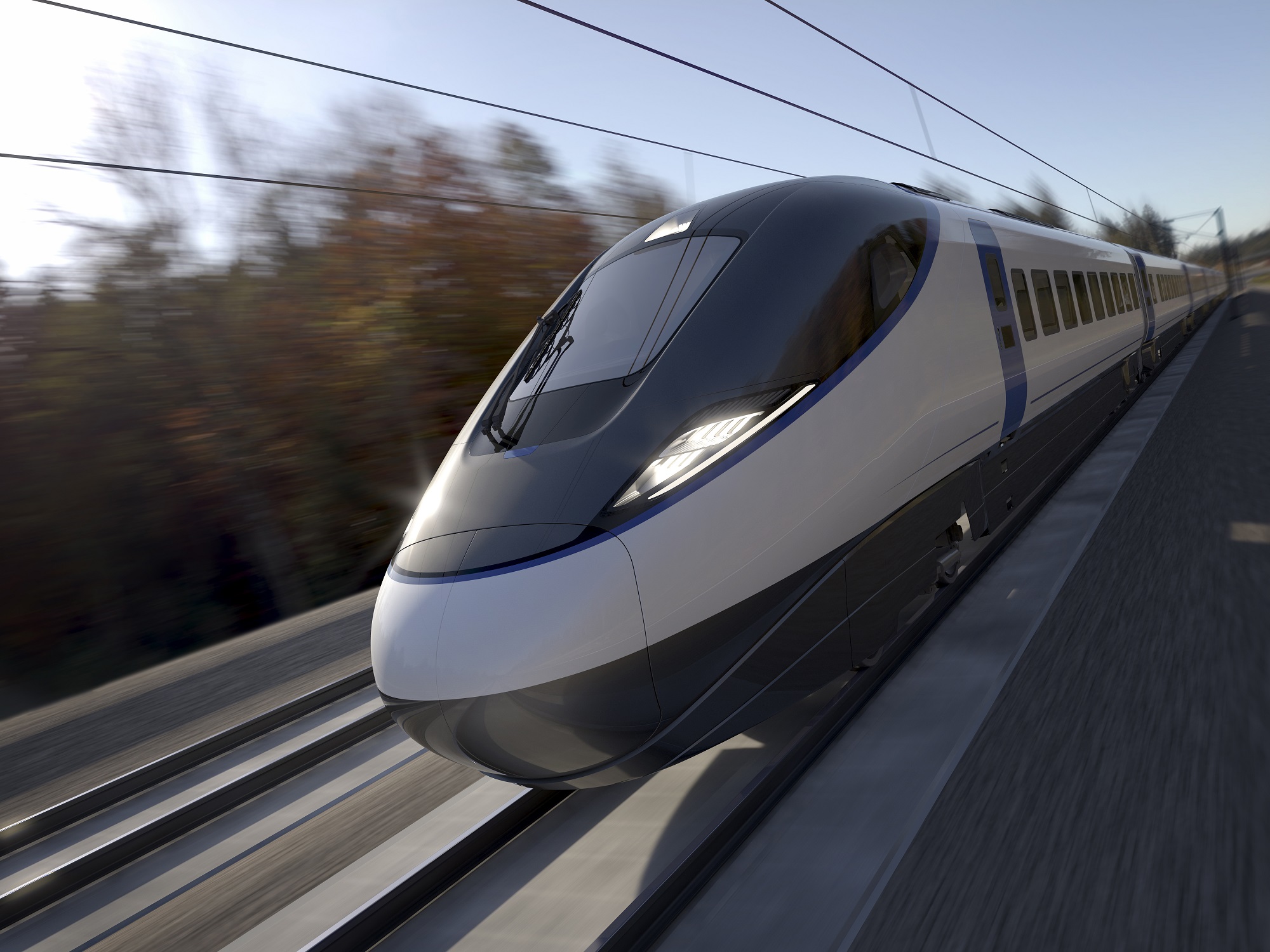

AIUI the 54 CC sets on order are sufficient only for the Phase 1 & 2a services:
Alstom and Hitachi Rail have today confirmed that the Hitachi-Alstom High Speed (HAH-S) 50/50 joint venture has signed contracts with High Speed Two (HS2) to design, build, and maintain the next generation of very high speed trains for HS2 Phase 1 as part of the £1.97 billion contract, including an initial 12-year train maintenance contract.
Additional trains for Phase 2b western leg services will not be ordered until the Hybrid Bill has been passed by Parliament.
The ITSS for Phase 1 & 2a does not include a Curzon Street to Scotland service. That appears in the ITSS for the full Phase 2b western leg including the Golborne link, but not in the ITSS for Phase 2b Crewe to Manchester without a WCML connection (see previous posts in this thread).
