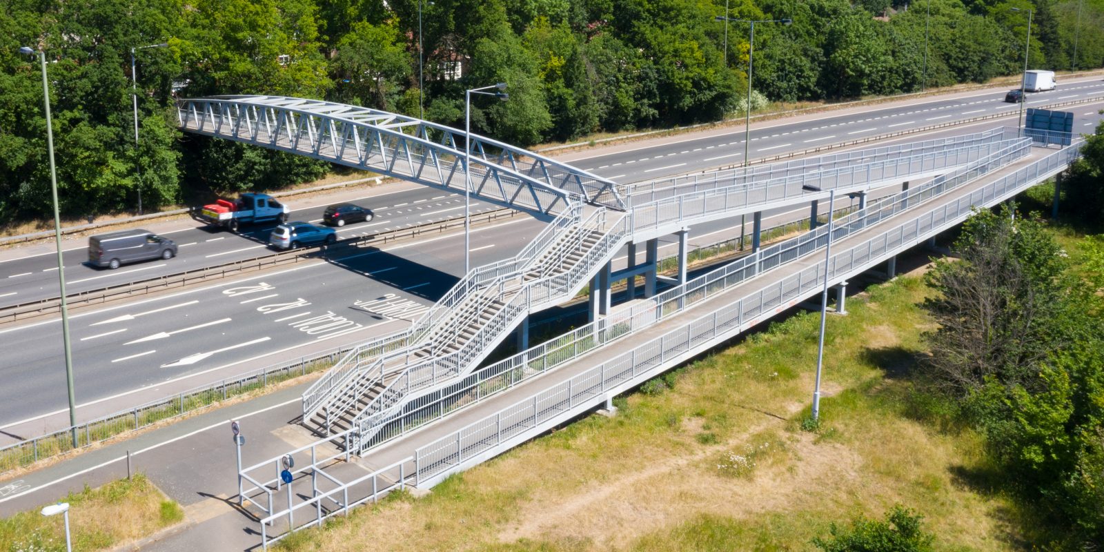

In the post eschede environment, would we expect a replacement structure (assuming the opportunity is not taken by Network Rail to attempt to fait-accompli a closure), to be a single span to remove the pier in the middle?
I would be surprised if a single span would work across a wide expanse without support in the middle. The embankments are mostly clay (with minimal topsoil) so would be susceptible to 'heave' unless a lot of support was introduced either end, which would be difficult to achieve without closing the railway itself - the site is pretty inaccessible to anything larger that a van. One end of the bridge is only feet from a dwelling, and the other a few yards from the Golf course car-park, which has very mature trees on it (and a dwelling yards away).
I would imagine something similar to the Shere Heath bridge (near Gomshall) would be required, and installed likewise by moving it there from the West probably via the A322 which fortunately has no low bridges between the A3 / M3.
This is what I can find on the Shere Heath Bridge, and how it was installed (likewise, no access except from the railway itself), although the North Downs railway is only 2 tracks.
https://lumiflonusa.com/case-studie...ong-lasting-high-performance-coatings-system/
As best I can tell from measuring Google's satellite view (so less than rigorous), the existing bridge is around 40 yards long (Google seems to operate in primitive units).
So even setting bankseats a bit further back, something like this could work:
Nusteel were awarded the contract to design, fabricate, paint and install this new bridge connecting Bexley and Bexleyheath. The structure is composed of a 52 metre partially Top-tied Bow Warren span
The Shere bridge seems to have used precast concrete abutments, which might work here as well. It's also possible to install in-situ concrete piles using a shell and auger rig, which can be towed by a Land Rover.
Of course there's still the task of erecting the deck. I don't know whether the bare truss would be within the lift capacity of one of the Kirov rail cranes. If not, the single span is probably ruled out.
Or two cranes...?
