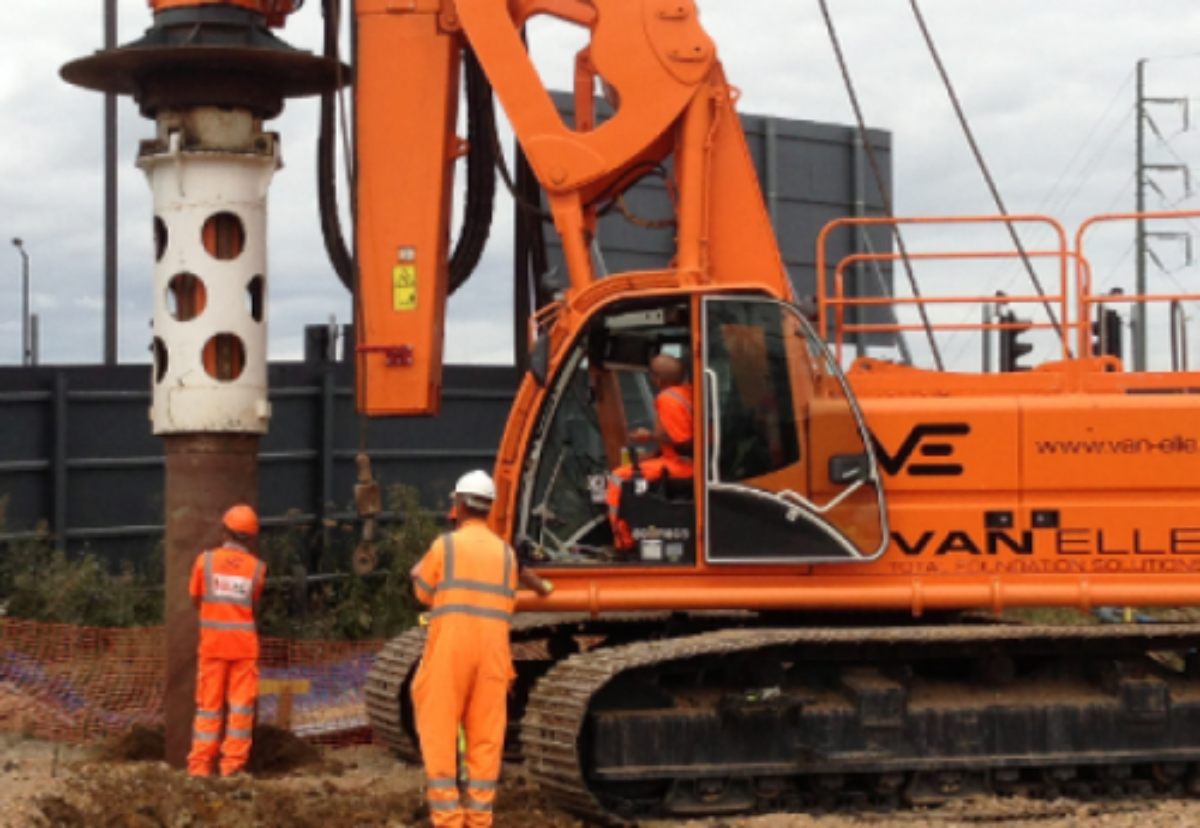

Pictures from LinkedIn of piles (some 10m!) being installed at Ashton Moss.
10m! pinning a 100m tall offshore wind farm to the seabed only use 30m piles
I'd imagine the diameters of the turbines are much wider, and don't have old mine working or shallow bell pits to contend with...
No just a very wet seabed.
Anyhow with the background and the calculations we will never know but what we do know is on GWR is foundation design was one of the key short comings in the design process. I also see these days that engineering judgement isn't prevalent anymore and that with all the sign offs required there is the potential for engineers to add their own safety factor on i suspect.
Very difficult to make that comparison given the different variables involved.
The 'ground' conditions of the seabed could well be significantly better than those on land in this case - you don't tend to get peat bogs on the seabed.
The piles used for offshore wind are absolutely massive - 7m diameter or more, compared to the standard 610mm diameter pile used on rail electrification.
And lateral pile capacity increases with the cube of the embedded depth, so going from a 10m pile to 30m will be about 30 times the capacity. Then the greater diameter will increase this by a further factor of 10.
