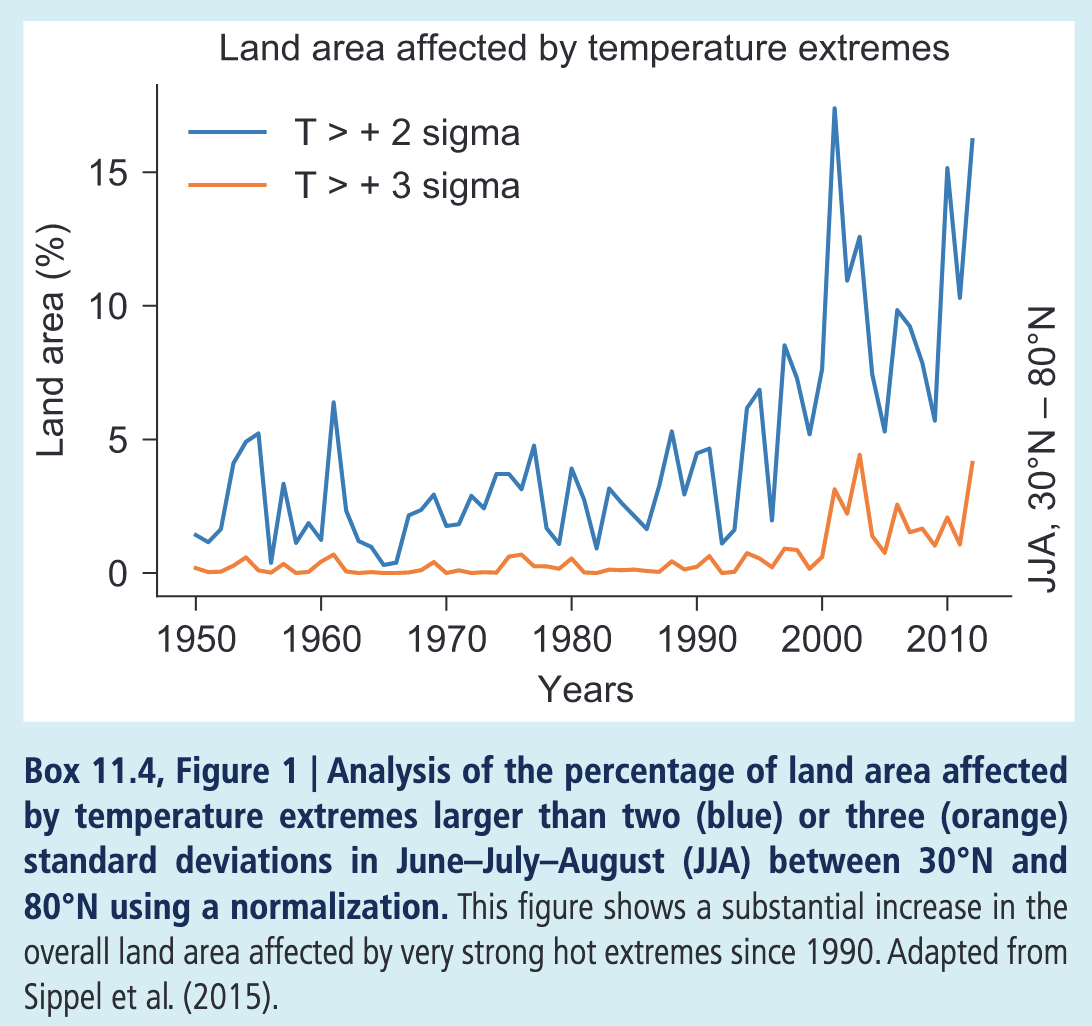

Global temperature only started rising in the 70s after most countries in the world replaced steam locomotives with diesels and the clean air act was passed.
This is false. Global temperature has been rising since at least the start of the 20th century and have been partially offset by aerosol emissions. Trends in surface air temperature due to anthropogenic forcing can be attributed as far back as the 1920's.
It's important to understand that the problem is climate *Change*, not specifically warming or cooling. A volcanic winter from Aerosols would be just as devastating to life on the planet as Global warming of 2 degrees. The 1880s Krakatoa eruption is thought to have pumped so much ash into the air that it depressed harvest yields globally and caused famine in a number of areas around the world. At least Volcanic ash is fertile, coal dust doesn't even give you that compensation.
It comes down to the rate and magnitude of change, the possible/likely consequences of that change, and adaptability. You only have to look at the UK rail network to see how even small perturbations can cause major problems.
