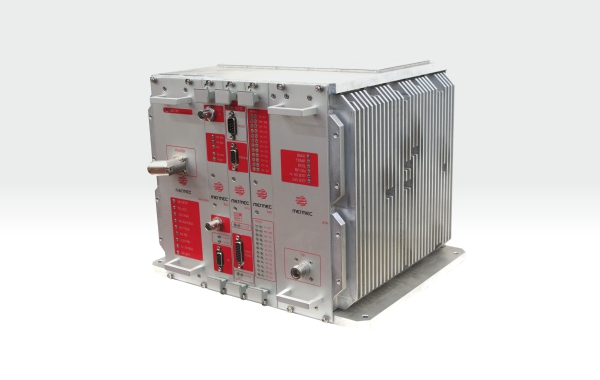

Electronic circuits aren't bulky.
It sure can be, especially for new technology:
That's an ERTMS balise transmission module and on-train computer system, as seen here. Based on the DB-9 ports (black rectangles) I'd estimate the former occupies roughly one cubic foot of space, whereas the latter is similar to a very large suitcase.
New technology? I see RS232 connectors and what appear to be coaxial connectors. The side of one appears to be a large heat sink.
I appreciate embedded systems need to be reliable - hence the use of older, more stable software. Still...
coaxial connections on a radio transmitter ... even if it's entirely a 'software radio' - what comes out of that coaxial socket is RF ...
Admittedly, I'm not au fait with electronics, but if something is always on or at the very least on for extended periods of time, as you'd expect an ERTMS module to be, and you need reliable performance, you would end up with a massive heatsink or otherwise ample provision for cooling?
But it's not new technology is it? The RF connector is positively prehistoric. As for the RS232 DB25 connector, it's seriously outdated.
I'd say it's overkill. I'm doubtful it'll be under as much load as say a server in a data centre, which require a much higher availability.
I couldn't find any specs for the system in question, the Mermec European Vital Computer.

How, exactly, is a connector 'outdated'?
Well assuming it's being used for an actual serial connection, the baud rate is low and, while the large voltage sweep allows for more resistance to interference, it uses a lot more power than other standards.
The standard was defined in 1969. My point was it's not new technology, which I feel is an entirely valid point.
Perhaps the designer considered resistance to interference more important than baud rate.
The trade off for resistance to interference is power consumption, not baud rate. It's also nothing a little extra shielding could not remedy.
Are you going to argue black is white and claim it's new technology then?

What's in the box is new, the connectors aren't. Can't we all just get along?
And what's in the box then? Please enlighten me. If I were a betting man I'd be willing to bet it's going to be in line with most other embedded systems, and given that most embedded systems favour stability, most hardware and software will be older and more mature so to speak.
Not a trade off but a feature of the connector as you said and I'm not claiming it's new technology but maybe in this application it's appropriate technology; furthermore to compensate for reduced noise immunity with extra shielding is poor design.
What connectors do you think should be used?
