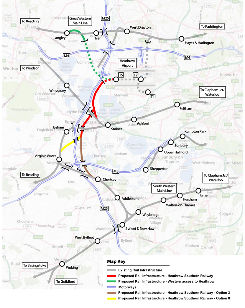

The Windsor line junction is embedded in the middle of Slough. It might just be feasible to reopen the western chord but the bigger problem is that grade-separation in either direction is not feasible. The southern pair of tracks are the main lines for express trains and without grade-separation, trains to/from Windsor would need to cross the whole GWML to go either west or east. It works fine when the Windsor branch is just a shuttle but that's not what this link would need to be about.
Looking at things, it doesn't actually seem to difficult to get the required grade-separation. There's a skip-hire firm all along the northern side of the railway, so splaying out the relief lines should be quite doable by using that land. You can't go over the existing rail lines due to the B416 Road bridge, so you would have to go under by digging out the western curve and putting in new bridges for the existing lines instead, and then you would rise up between the splayed relief lines.
Missing Slough would be a big connectivity loss, though.

The Southern Access to Heathrow is due to have train services from Basingstoke (more on that later), Guildford and that little station Waterloo (you may have heard of it). As such far more than just the few places you mention.
I think you misunderstand cle. I believe they were saying that the yellow line/option 8 towards Virginia Water wouldn't be needed if the Western Access was built, implying the brown line/option 3 for Southern Access would be the right answer.
32,766
I think you've completely missed the point here. In the above context I'm sure Cle must have been comparing the yellow and brown options, and basically saying that the ability to run towards Reading loses some of its usefulness if WR access is already in place.
Yes exactly, thanks. My point was that with the western access scheme extant by this stage (and offering Slough as well as faster Reading) - the option 8 on the southern towards Bracknell is not so attractive.
And also that Basingstoke via Reading would be on the reliefs, and thus create an issue crossing (as I remember it, but glad to be wrong, the diveunder at Reading is from Southern to relief lines, not the opposite which would be needed). Whereas the SWML is paired by direction...so switching to the fasts would be easier - am I correct here or missing something?
32,766
I’m a little confused by what you are comparing now.
For Heathrow to Basingstoke services there would only be two main options, either by Western access and via Reading; or via Southern Access and Woking (using the existing grade separated curve at West Byfleet), with the latter having the sub options of via Virginia Water or not, using the new direct line towards Chertsey. The main point is to avoid level crossing issues by piggy backing alongside the M25 corridor.
I don’t think any scheme has ever proposed Heathrow > Virginia Water > Ascot > Reading > Basingstoke, has it?
However it is quite possible to run a train from the Southern across Reading towards Basingstoke without conflicts, a down train could just use P7, and an up train could use the underpasses at both ends. I doubt it is the best use of capacity though.
cle
17 Nov 2010
4,589
Nope I wasn’t suggesting that - I was saying the route via Bracknell was redundant with the western access assumed to be active at that stage.
And a second point that from the western and relief lines to Basingstoke was problematic - as the diveunders at a Reading are from southern line upwards rather than reliefs to Reading West. And thus heading to Basingstoke and beyond would be best via Woking.

I thought (and this link looks like it confirms it) that the new layout allows trains from Basingstoke to cross over to the relief lines and allows XC services to come in on the reliefs from Didcot and cross down towards Basingstoke as the mains towards Didcot go up over the bridge.
Using the Southern Approach to go to Reading via Ascot could be a good diversionary route.

You raise an interesting point about level crossings - How many of them are there on each of the route options. I seem to recall spending many happy hours as a motorist pausing at Addlestone and Chertsey Stations.
Chertsey has a Bridge now (about 15-20 years old). The main issues are around Egham which the AECOM HSR Southern proposal avoids.

All good questions - there has been a mention of through services from Southampton to Heathrow via Reading and Western Link in one of the route studies, but generally speaking there are also said to be capacity problems anywhere west of Basingstoke - for example this has always been given as the reason not to extend the second XC Reading service to Southampton. Taking the intermediate calls between Reading and Basingstoke into a through service could be feasible, but the more calls you have the less express it is.
Then you have the added possibility of Basingstoke grade separation, Woking Grade separation, Micheldever extended four tracking, etc etc. All future line capacity changers. I think however it's probably likely that it will only be one route from Basingstoke, whatever that turns out to be.

Based on the fastest option for the southern approach a train running Heathrow, Woking, Farnborough, Basingstoke would be about 7 minutes slower than Heathrow, Slough, Reading, Basingstoke.
If you used the Heathrow services to replace the current Reading-Basingstoke services it would be a comparable time.
It's why I've previously suggested that the Southern Approach Trains should probably call at all stops as those from Basingstoke probably would probably opt to either go via the Western Approach and/or change at Woking. However it would pick up quite a lot of other passengers of it were to do so.
