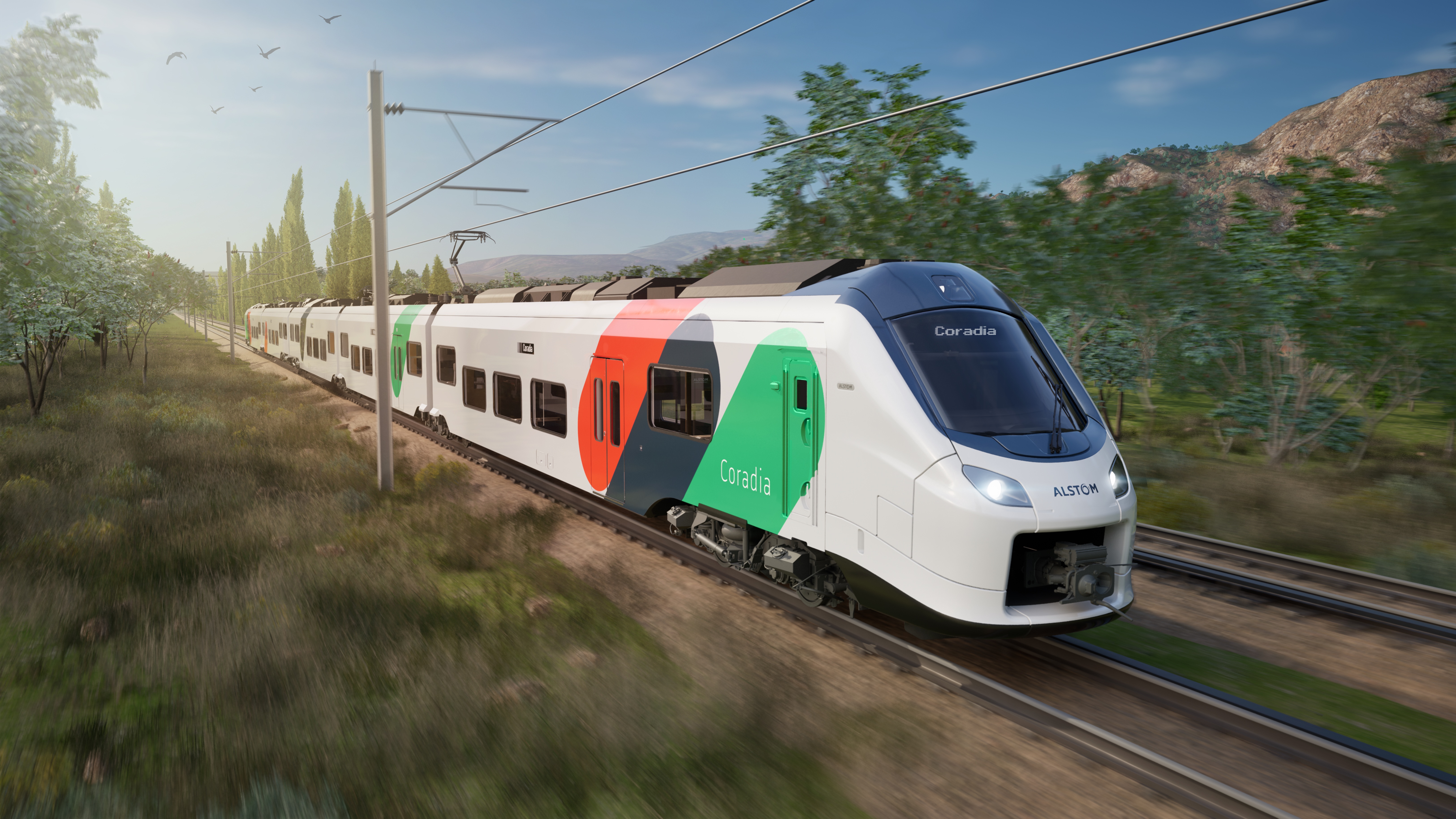

Finally, here is the winning proposal:
Gag Halfrunt
23 Jul 2019
586
The other trains in the bottom left-hand corner are XTrapolis Adessia, so the CP trains will probably be branded as Adessia as well.
The Coradia brand is used for low-floor trains.
