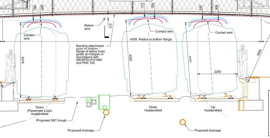

Very little change through Dewsbury station...see snapshot. It looks it's around half a track width at most at the Leeds end.
