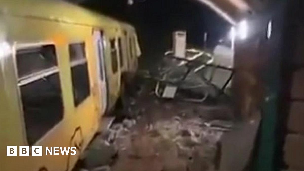

This from BBC Merseyide posted at app 1530..( also states wrong info on train as it happenend about 1900 .not 1835 )
It was the 1835 off Central.

"Metro" report in case it adds anything
A train has derailed at Kirkby station on Merseyside causing major damage. An investigation has been launched into how the train managed to leave the tracks and hit a buffer stop just after 6.30pm on Saturday, causing significant damage. The driver of the Merseyrail service was taken to Aintree Hospital by ambulance as a precautionary measure. In total 12 passengers were on board the 6.35pm travelling from Knowsley toward Liverpool, along with two crew members. The passengers all managed to walk off the train following the smash and were checked by paramedics at the scene. They were described as ‘walking wounded’ with minor injuries.
The train struck the buffer stop, a device designed to prevent railway vehicles from going past the end of a physical section of track. The derailment caused a massive amount of damage, and photos and video from the scene revealed a significant amount of debris, rubble and smashed up concrete. Sections at the platform’s side appeared to have caved in due to the island led to an urgent meeting between officials from Merseyrail, Network Rail and emergency services. Reports from the fire service that the train also hit a bridge remain unconfirmed. A Merseyrail spokesperson said: “A full investigation is now underway into the circumstances surrounding the incident and Kirkby station will remain closed until further notice.” A spokesman for the British Transport Police added: ‘We were called to Kirkby railway station, Merseyside, at 7.01pm today (13 March) following reports that a train derailed while travelling into the station. ‘Officers, paramedics and fire services attended – thankfully no one sustained serious injuries. ‘Enquiries are ongoing and we are still investigating the full circumstances surrounding the incident.
