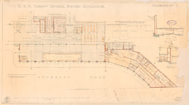

The below plan generated from openstreetmap and linked from Wikipedia shows the layout. The booking hall does have a wall next to the track on the line for 0 and hence that wall would have to go to allow the platform to be extended. The image shows the booking hall in brown against the track for platform 0. Platform 0 is offset to the left in the picture.
IF the building is not moved then the booking hall will have to go and only a facade be kept.
I would be using the land between the faces of 4 and 1 to get an extra island in, but that would mean losing all the buildings. Most facilities would be on a wide bridge at the west end and only small facilities would be on the platform a la Reading.

I have just found these superb drawings of Cardiff Central on the Network Rail site. I had no idea that there was so much space under the tracks - including a beer cellar!!
