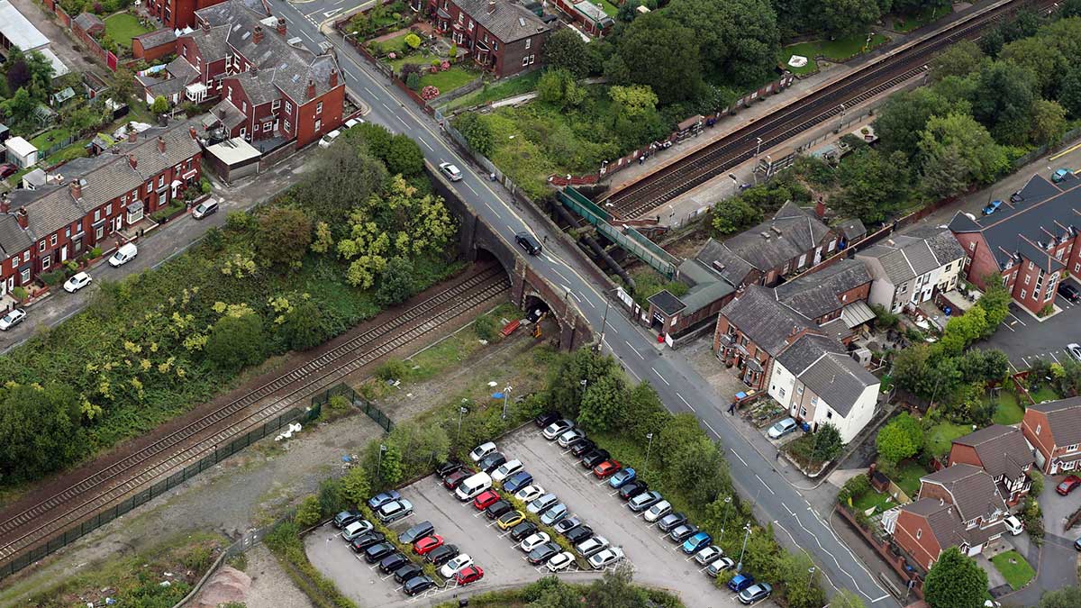

The Deep Pit Iron Bridge, just West of Hindley Station has had its southern ramp detached and removed ready for jacking later this month.

Later on I would love to see the earthing/equipotential bonding for that metal structure. Not that difficult of course but still looking forward to see someone post about it. I know - I am nerdy!

Presumably bonded at both ends directly onto the earth return rail/ nearest structure

With 25mm^2 copper conductor sheathed in yellow/green PVC?
From my own earthing/bonding experience, bonds to the rail/OLE structures tend to be 19/3.25, which clocks in at 158mm^2! The PVC also tends to be black.
25mm^2 is very much for lower voltages - you get those diameters (and the traditional green & yellow PVC) in on signal bonds, LOC cabinet bonds etc.

An earth conductor has to limit the "touch voltage" of the metal object in the event of a fault to 50V in your home or 60V on the railway for some reason, both relative to ground and to anything else within touching distance and to cause disconnection within a certain time. Hence the large cross section.

Earth bonding in OLE areas has also to guarantee the very short fault disconnection time and voltage rise on the earth conductors Ron very stringent values
