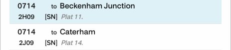

How does this work? On the new timetable it shows 2 services both going via Peckham Rye leaving the exact same time from London Bridge.
Will be a publication failure, one of those trains is supposed to be cancelled for the remainder of the timetable.
Both the NRT table 163 and the Southern web table H show the correct movements, the 0714 to Beckenham Junction runs, the 0714 to Caterham does not. This was queried and confirmed with GTR before either publication was made public, the cancellation simply hasnt made it in to data systems yet
No, that's not quite the case, I can't say what's actually happened here but its much more complicated than the cancellation hasn't made it in to data systems yet.
It’s the only Caterham service of the day that’s shown there

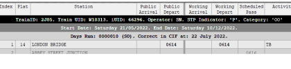

sorry, bad phrasing on my part, should have said that 2J09 0714 SX London Bridge to Caterham has not had its dates of operation clipped to end in Sep like everything else has, still wrongly shown as running to Dec
There appear to be some Ghost Caterham trains in there. I think all trains via Peckham Rye and Selhurst are supposed to terminate a East Croydon going forward
